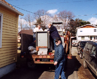

As Don, N2IVW, backed his stake body truck, bearing the PA and power
supply cabinets, onto Norm's lawn and up to the front porch, the sun was
shining, the air was mild, and there were still donuts left in the kitchen
-- all excellent omens for the task ahead.

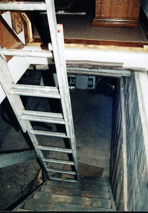

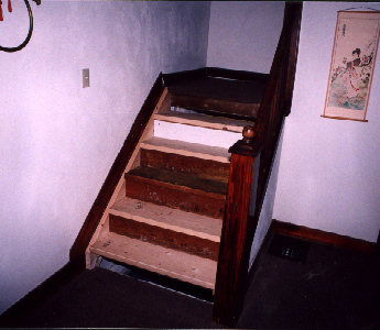

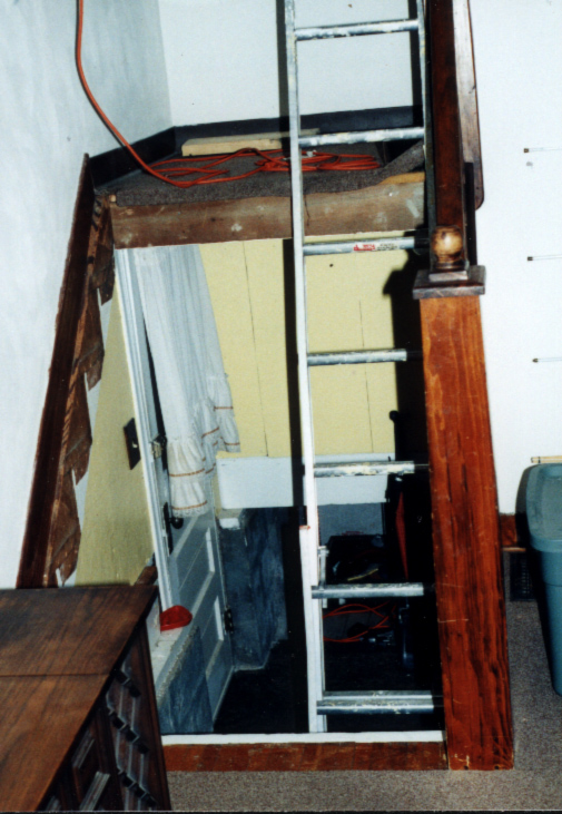

Inside, Norm had already bolted a winch to the landing between the first
and second floor. The winch is a trailer winch that, until the 21E
project got the green light, had been up on Norm's roof where it was used
to raise and lower an antenna mast. Now the winch's multi-strand steel
cable dangled above the access hole to the basement steps created by
Norm's removable stairway.
Norm's plan -- and as we've seen, he is a thorough planner -- was that the
cabinets would be offloaded already strapped to the appliance dolly, the
dolly providing not only mobility, but extra hand holds as well. Once
each cabinet was through the front door, it would be wheeled through the
dining room and laid flat at the edge of the basement access hole. The
winch cable would be fastened to the cabinet and Norm, manning the trailer
winch, would slowly, with guidance from above and below, begin to lower
the cabinet, on its side, to the basement steps. Once the cabinet was
resting lengthwise at an incline on the basement
steps, cable would be paid out from the winch and the cabinet, assisted by
gravity, could be guided to the basement floor. But first, the Weasel who

instructions and location assignments were made, was the first cabinet
strapped to the appliance dolly and removed from the truck.
First to enter would be the PA cabinet, the larger of the two cabinets
we'd taken from WEBO's transmitter site that morning. With more grunting

.We went to our assigned locations and Rigger Joe
went to the basement where he would use a pair of ropes to guide the
cabinet as it made the perilous descent to the basement steps.
With Joe, N2YR, and I stationed at the head of the basement stairway, and
Norm manning the trailer winch up on the landing, directly above our
heads, the rest of the Weasels in the dining room began to guide the heavy
cabinet to the edge of the basement access hole.
Ropes and cable were kept under tight control as the cabinet edged out
over the drop. As the load slowly began to lift from the floor, it had to
be kept from swinging. A swing to the left would damage the wall beside
the stairs, while a swing to the right would ding the wood trim, or the
newel post or the banister and rails. It seemed like a long time before
cabinet was free of the floor and suspended above the access hole. Now
began the chore of lowering the cabinet to the basement steps.
Slowly, one click at a time, Norm began to roll out cable and line and the
cabinet slowly start to drop toward us. We could still see Rigger Joe
down in the basement with his guide lines as he called out instructions,
but the cabinet now almost entirely blocked our view of the access hole
and what lay beyond.
The cabinet continued to drop, and then we had to guide it back towards
the wall opposite the head of the basement steps so the cabinet would
clear not only the edge of the dining room floor, but that head bashing
"I" beam beneath it.

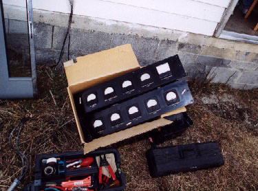

into the basement. All that remained was to bring doors, meters, tubes,
and other parts that had been removed from the cabinets that morning down
to the basement. This was quickly accomplished, and then it was beer and
